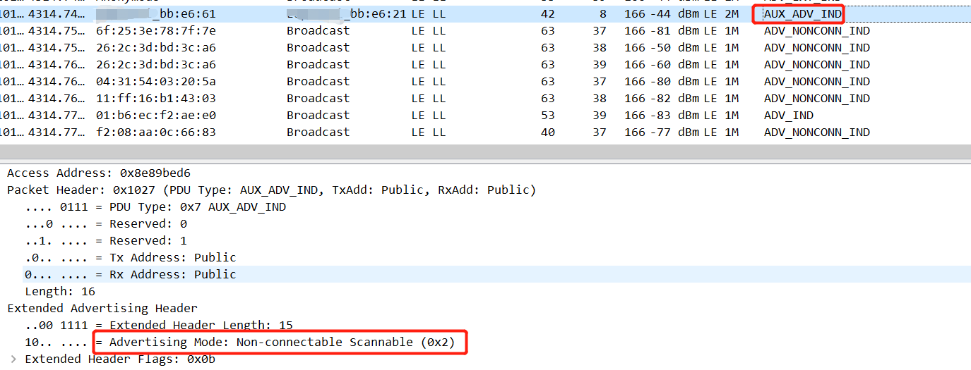

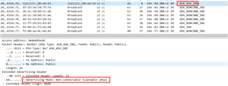

Hello Nordic Experts,
Recently, I am using the nRF52840 dongle to sniff the Scannable Directed event, but I found that the AUX_SCAN_REQ cannot be sniffed, but the SCAN_REQ can be captured. can you give me a hand and check what happened? the details as below::
  • sniffer version: 4.1.0
  • Wireshark: Version 3.6.2 (v3.6.2-0-g626020d9b3c3)
thanks.
Parents Reply
  • Hello Vidar Bro,
    yes, I tried to select the device from the dropdown menu after restarting several times, but I cannot find it from that, however, the device indeed is advertising. I can find it on the captured windows. it is very strange, but I can confirm that it works well when the event type change from scannable directed event to scannable undirected event.  it seems that it is a bug of nRF Bluetooth LE sniffer firmware, the device list may discard the device which is scannable directed event.
