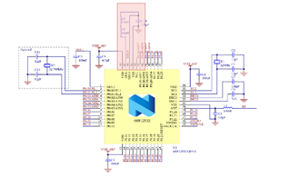

    As for the 32KHz source, where do I go check to see if the external crystal is enabled or does it just default to the internal 32KHz source by default?
    You can see which clock source the Softdevice the will be configured with from the NRF_SDH_CLOCK_LF_SRC symbol in sdk_config.h. Our SDK BLE examples have the LF crystal selected by default.
  • Adding static as you suggested fixed the beacon data issue.  I found the NRF_SDH_CLOCK_LF_SRC symbol and changed it as you suggested and verified operation still worked after disabling the 32KHz crystal.  So now, I am back on track again.  So I have a few more questions if you do not mind.
    1. Is the internal DCDC regulator enabled by default?
    2. When I ran the online power profiler and plugged in the variables for my application, I liked the result that it came back with.  Does the profiler take into consideration not really going into sleep (System On) but rather Idle as in the case of the beacon app example?  Does the profiler take into consideration the other passives on the board that allow the micro to function?
    3. Can you point me where I need to go to adjust the TX Power output of the beacon?
  • Good to hear that it works now. Note that the 32 KHz crystal will give you a slightly lower average current if you have the option to choose.
    We use the LDO by default, but you can call sd_power_dcdc_mode_set(NRF_POWER_DCDC_ENABLE ) after ble_stack_init() to enable it.  However, before you enabling it, please make sure you have the DCDC inductors included in your design:
    Otherwise, you may risk bricking the device.
    2. Idle and system ON is the same in this context. I.e. the device enters System ON when you call the idle function from your main loop.
    Yes, the power profiler data is based on actual measurements.
    3. sd_ble_gap_tx_power_set(BLE_GAP_TX_POWER_ROLE_ADV , 0, <tx power>).
