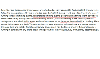

  •        In the SoftDevice scheduling documentation, It said the centle and peripheral roles are scheduled indepently. I have underline it with red line in the pic below.
           so we think it hub have centle and peripheral roles. there will be collsion.
           But If the hub as peripheral role send connect paramter request message with ReferenceConnEventCount and offset0--offset5 ,  the peripheral role also can schedule  the timeslot .and anchor point.
            I don't know the reason why nordic say there the centrle and the peripheral are scheduled indepently. Can you tell me?
            And I want to know If there is a collision, Will the SDK adjust the timeslot by send connect paramter request message to the centrle or send connect update request to the peripheral?

    This is because it is the central that determines the connection parameters entirely, which means that in the peripheral role the device will have no say in what connection parameters will be used - it can only request to have them updated to its own preferences, which the central device may decline.
    So in the multirole setting the SoftDevice is able to neatly schedule multiple central roles, but whenever it enters into a peripheral role it will have to follow the direction of the central in the connection.
    The priority of the different events will then follow the table from the scheduling documentation you reference above, to make sure that the connection run as smooth as possible.
    If there is a collision then the SoftDevice will follow the priorities listed in the documentation - it will not send connection update requests on its own, so if you would like for this to happen you must implement it into your application yourself. I would suggest that you then move the central timeslot that is colliding, since the central is the one that decides (so you do not need to rely on the other central to resolve your collisions).
    For more information you could also see the answer by my colleague Einar here.
