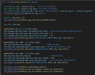

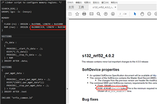

I need more flash and ram so I change the sdk to 13.1, but when I enabled the softdevice the log advice me use more ram.
How can I use little ram as s132_nrf52_4.0.2_release-notes.pdf say? Thanks
    If you've added quite a few services or concurrent connections to your application, which all will use some RAM in the SoftDevice. You can take a look at this case, where a few ways to reduce the SoftDevices RAM usage has been suggested.
    You also could turn off the features in the sdk_config.h if they are not used in the project.
