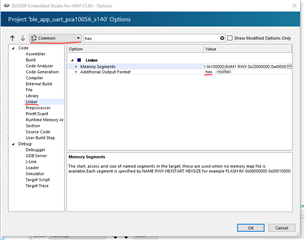

Hi
1、Can the SES build a .bin instead of .hex?
2、How to download the .bin file to nrf53832?
Hi
This is not something that I have tested, but I see that the "additional output format" is set in the "Linker" section in the project settings:
You can try to set it to bin (it is an option in the drop down menu).
Again, this is not something I have tested. Why do you need that? If it doesn't work, I believe this is actually a question that would be better suited for Segger.
