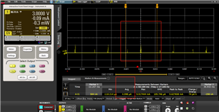

SYSTEM ON:NO RAM,RTX wake up, Power Management: 4 μA at 3 V ,why?

    The RAMON register is deprecated in nRF52, you should not use it. Instead, you should use the RAM[n].POWER registers.
    It seems that the max current in your measurement is over 5 mA, which indicates to me that the CPU or radio have been running during the period. If 4uA is the average current including wakeup event, it does not seem too high. Have you tried measuring the base idle current only?
