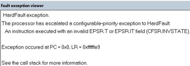

    I trace it and found the point where i am getting hard fault.
    ret_code = sd_softdevice_enable(&clock_lf_cfg, app_error_fault_handler);
    The result is same even after using nrf_dfu_mbr_vector_table_set() and not nrf_dfu_mbr_irq_forward_address_set() in the bootloader code.
    And the value of registers are mentioned below:
    And yes the only chage in my application is in .icf file that is flash start address change.

  • I see... Can you share your bootloader code, where you branch to the application, including configuring the MBR etc? Please include enough context, so include values of constants that may be set elsewhere etc.
  • HI,
    pca10056_usb.zip
    I have attached the bootloader code here.
    In main.c line no 218. i am calling "nrf_bootloader_app_start();" API to jump to the application part.
    And inside nrf_bootloader_app_start() function i am given the start address as the application start address(0xED000).
    And also calling the function nrf_dfu_mbr_init_sd() & nrf_dfu_mbr_vector_table_set() as you mentioned.

  • Hi Einar,
    The issue got resolved.
    I found that under DFU we are also calling ble_stack_init() function. But there is additional data added in that function.
    So same thing i am calling in ble code under ble_stack_init() function. And after that its working fine.
    actually we need to use these two function calls on both the places once in bootloader before jumping to application and second is inside the application.
