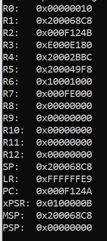

    I trace it and found the point where i am getting hard fault.
    ret_code = sd_softdevice_enable(&clock_lf_cfg, app_error_fault_handler);
    The result is same even after using nrf_dfu_mbr_vector_table_set() and not nrf_dfu_mbr_irq_forward_address_set() in the bootloader code.
    And the value of registers are mentioned below:

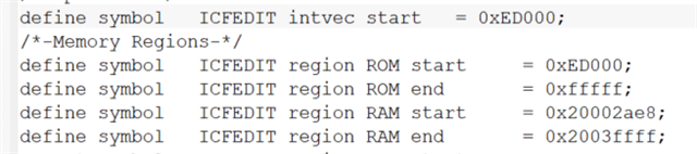

    And yes the only chage in my application is in .icf file that is flash start address change.
    Previously it was
    And Currently i changed it to this
    in previous case the application address was 27000 so in that case i directly flashed it without bootloader code.

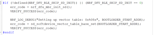

  • Hi Einar,
    The issue got resolved.
    I found that under DFU we are also calling ble_stack_init() function. But there is additional data added in that function.
    So same thing i am calling in ble code under ble_stack_init() function. And after that its working fine.
    actually we need to use these two function calls on both the places once in bootloader before jumping to application and second is inside the application.
