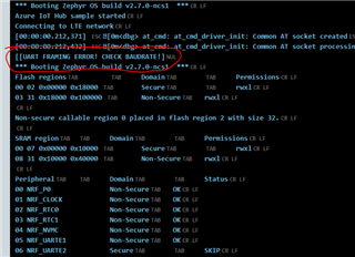

Nordic thingy 91 Azure Iot Sample gives UART FRAMING error
I am trying to add a Nordic Thingy 91 to my azure Iot hub.
i've configured the device according to the guide
https://developer.nordicsemi.com/nRF_Connect_SDK/doc/latest/nrf/libraries/networking/azure_iot_hub.html#prerequisites-for-connecting-to-azure-iot-hub
I've provisioned the ceritificates,  and I have the sample code working on a 9160 DK. I am now trying to do the same with a  Thingy 91. Im om course using another set of device name, certificates and sercurity tags.

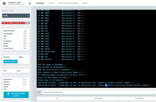

I am using the DK to flash the NordicThingy91, which works fine. I'm then using the LTE link Monitor tool for the terimnal to look at the results.
I have enabled
CONFIG_BOOTLOADER_MCUBOOT=y
CONFIG_AT_CMD_LOG_LEVEL_DBG=y
CONFIG_LTE_LINK_CONTROL_LOG_LEVEL_DBG=y
Im using VScode with the NRF connect extension. Im doing an "erase and flash".
I am not sure if the UART error even.  When running the code withouth any debug i get the following result:
Any help is appreciated!
it runs twice and produvces this error on the first run:
The next run it gives teh same, withouth the UART error
--------------------------- New first error ----------
