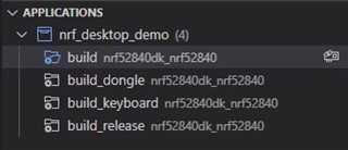

  • Pristine build doesn't work when I add the prj*.conf with "Extra CMake arguments". It seems like that the west build command that is called by the extension uses an empty string instead of the project configuration I configured. This is the build log when I try to do a pristine build:
    Building nrf_desktop_demo
    west build --build-dir d:\dev\_temp_projects\nrf_desktop_demo\build_dongle d:\dev\_temp_projects\nrf_desktop_demo --pristine --board nrf52840dk_nrf52840 -- -DCMAKE_EXPORT_COMPILE_COMMANDS:BOOL=On -DNCS_TOOLCHAIN_VERSION:STRING="NONE" -DCONF_FILE:STRING="" -DDTC_OVERLAY_FILE:STRING="d:/dev/_temp_projects/nrf_desktop_demo/configuration/nrf52840dk_nrf52840/app.overlay"

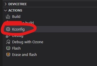

  • The Kconfig window in the VS Code extension doesn't open when I add the prj*.conf with "Extra CMake arguments". No errors are popping up or shown in the terminal.
    I also tried the guiconfig option but that gave me an error although the same west build command call worked when I manually copied the line into the terminal.
    > Executing task: west build -d d:\dev\RoomController\roomconplus-nrf52\firmware\build_bgr100664_nrf52840 -t guiconfig <
    The terminal process failed to launch: A native exception occurred during launch (File not found: C:\dev\NordicSemi\ncs\v1.9.0\toolchain\cmd).

In the following I will describe how I created my demo development environment:
  1. I created a new application from sample with this settings:
  2. I added a build configuration that uses the default prj.conf:
  3. I added a build configuration that uses the prj_dongle.conf:

    My second problem was with the Kconfig action not opening the Kconfig window in combination with a different project configuration than prj.conf (e.g. prj_dongle.conf).
    Were you able to also recreate this problem on your side?
    Is there anything I can do to make the Kconfig action work?
    David
  • Hi David,
    Yes, the pristine build option can be quite troublesome at times.. Our developers are trying to implement a more systematic solution. I am not sure what you are asking about here.. You can access the KConfig files from the build folder and open it with VS Code..
    Swathy
