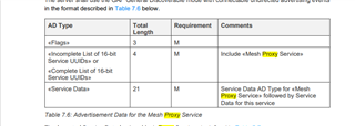

    How do you change the advertised name of a mesh node during operation - the name broadcasted by the proxy model?
    You can see the node name defined as GAP_DEVICE_NAME in nrf_mesh_config_app.h, but changing it programmatically can be a bit more work. You would have to use the function sd_ble_gap_device_name_set() that you can see in ble_softdevice_support.c and then adv_data_node_id_set() from proxy.c. adv_data_node_id_set is also a static function, so definitely have to modify several parts of the code. There are unfortunately no straight forward API or way to do this, but it should be possible.
    Is the vendor id, device id and firmware version already part of the proxy models advertising data? If not, how do you add it to the proxy models advertising data?
    In section 7.2 in the spec you can see that none of this is being advertised, and what is being advertised is required. You can add what you need to this however, as long as it doesn't end up being longer than 32bytes.
