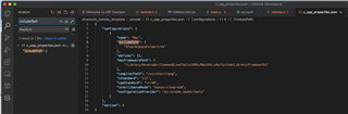

    The red lines under the includes, it is that VS Code IntelliSense can not find these includes.
    However, the build configuration of the project might still be able to work, as these are two different systems.
    I suggest that you try to build, and if it builds fine you can ignore the red lines under includes.
    See this devzone case for some discussion on the include error. There should also be some other cases about the same type of issue  if you look around.

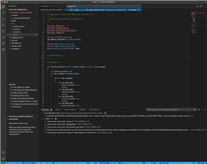

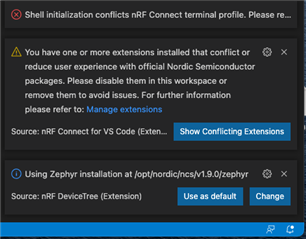

  • Hi Sigurd,
    I selected the nrf5340dk_nrf5340_cpuapp for the Build Configuration based on the information you provided in the other post.
    This is what I get when I do the Build:
    Looking at the other post about JSON files, this is what I found:
    Is this correct please, or does it need modifying?

  • Hi Al,

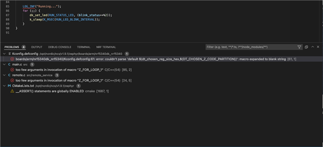

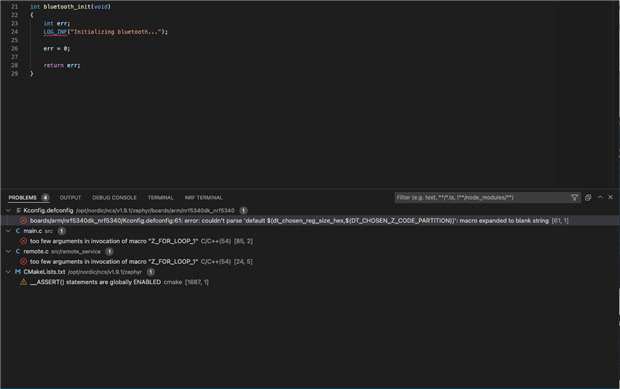

    First, what does the "Terminal" beside the "Output"  tab show after you build?

  • Hi Sigurd,
    I deleted the application and then relaunched VS Code via nRF Connect for Desktop.
    I used 'Add Application' to point to the bluetooth_remote_template folder in my workspace folder and then created a build configuration for the nrf5340dk_nrf5340_cpuapp using the nRF Connect SDK 1.9.0. I then did two successive Pristine Builds resulting in the same 11 problems shown in my previous post. I've attached the Terminal output from these two builds.
    > Executing task: nRF Connect: Generate config nrf5340dk_nrf5340_cpuapp for /Users/alwalker/workspace/bluetooth_remote_template <
    Building bluetooth_remote_template
    west build --build-dir /Users/alwalker/workspace/bluetooth_remote_template/build /Users/alwalker/workspace/bluetooth_remote_template --pristine --board nrf5340dk_nrf5340_cpuapp -- -DCMAKE_EXPORT_COMPILE_COMMANDS:BOOL=On -DNCS_TOOLCHAIN_VERSION:STRING="NONE"

  • Hi
    From the Terminal log you sent, the projetct actually builds sucessfully, and you should be able to flash it to the device if you want.
    After you do the pristine build and get these errors, try to restart VS Code and see if the errors still persists in the existing project?
    In your settings, I see you use clang as the compiler used for intellij. Try to set the ncs gnuarmemb as this instead.
    It should be located something like. ""/opt/ncs/v1.9.0/toolchain/opt/bin/arm-none-eabi-gcc"
    Does any of these suggestings fix your issue?
