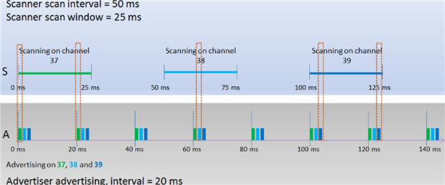

In this page Connecting to advertisers performing extended advertising, I think I'm in the variant #4 but I never get the timeout event...

    No. Not on the link-layer. But you can add some delay for when you call sd_ble_gap_connect(). The advertiser will have the radio in RX mode in a short period after sending the advertising packet. The central/scanner need to send the connection request packet in this short window after receiving the advertising packet. If you add some sending delay here, the advertiser will not receive the connection request(because the radio is no longer in RX mode). When you call sd_ble_gap_connect(), the central will listen/scan for a advertising packet(from the address you set when calling the connect function), and it will send the connection request packet if it receive a advertising packet from the specified address.
