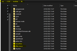

but it didn't work -> After I checked for similar problems I found, that tensorflow is not in the name-allowlist in west.yml.
What I tried:
- added tensorflow to the name-allowlist in west.yml
  name-allowlist:
      - tensorflow
      - tflite-micro
- added repos in west.yml
    # Tensorflow
    - name: tensorflow
      repo-path: tensorflow
      path: modules/lib/tensorflow
      revision: dc70a45a7cc12c25726a32cd91b28be59e7bc596
      remote: zephyrproject
    - name: tflite-micro
      repo-path: tflite-micro
      path: modules/lib/tflite-micro
      revision: d30cdac11bff4df6f50bae1a14753b76bde8e4d3
- run `west update`
But still the config is not working
and I can't edit Kconfig in VSCode (value cannot be changed)
because Direct Dependencies: (=n) ?
and the build fails

    I would recommend you to try our Edge Impulse samples instead.
    We already have the full setup and training done on Tensorflow, also the export for tflite-micro. I assumed the example project for tensorflow would work...

    Tensorflow isn't supported on NCS right out-of-the-box unfortunately, Edge Impulse is. If you want to use Tensorflow however, I think you would have to use the upstream version of Zephyr. Take a look at this case for further details. The customer in that case is struggling with somewhat the same issue as you.
