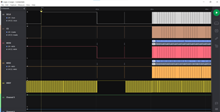

Trouble getting SPI to work together with BLE
I have been working on a setup where I connect a sensor (TI ADS1299) to the nRF5340-DK 2.0.0 using an SPI connection and transmit the recorded data using BLE. I have been able to get the SPI connection and the BLE connection working separately, but when combining the functionalities a problem arises. The program builds and programs fine, but when running it, the SPI connection does not seem to be working properly. All registers that store the data are left empty, instead of containing the measured data. The BLE connection does still work but only transmits zeros, probably as the result of the SPI connection not working as it should.
What could be the problem here? Do the nrfx_SPIM and BLE functionalities interfere with each other?

  • I do not see any obvious reasons for why this works fine without BLE, but not when it's enabled. You haven't changed the pinout by any chance? I notice you are using P0.02 for the chip select line and that you have set the CONFIG_NFCT_PINS_AS_GPIOS option, but have you also remembered to short R42 and R45 and remove the 0R resitor on R43 and R46 on the board?
    NFC antenna interface
    A scope or logic analyzer capture of the SPI transfer would be helpful if we need to troubleshoot this further.
  • Thank you for your response,
    In the original SPI code, I used P1.01 for the chip select. After combining the SPI code and BLE code I got the same issue I described in this post. I found somewhere that P1.01 might be used by the BLE connection, so I tried another pin (P0.02) for the chip select. I did not know about the need to short/remove the resistors from the board to use P0.02. Perhaps using another pin is more convenient in this case. I will try some others.
    I sadly do not own a scope or a logic analyzer, but I might be able to borrow one if using another pin for the chip select does not help.
    Thanks for your help,
    C
  • I have tried using several different pins from the GPIO_0 and GPIO_1 for the chip select, but none of them seem to be working. Using a logic analyzer does show that the chip select seems to be malfunctioning (see picture). In this test, P1.01 was used as the chip select pin, as that was the pin that was working in the original code. I have attached the original code used to set up the SPI connection.

    Can you try use P1.04 for CS instead? P1.01 is assigned to the network core for UART0 TX by default and therefore not accessible for the app core.
    	gpio_pin_configure(gpio_dev_1, 4, GPIO_OUTPUT);
        gpio_pin_set(gpio_dev_1, 4, 1);
    Edit: P1.01 ("33") gets assigned to the network core in the startup file here: https://github.com/nrfconnect/sdk-zephyr/blob/c3208e7ff49d22d8271f305344382e9306fdde99/boards/arm/nrf5340dk_nrf5340/nrf5340_cpunet_reset.c#L35
