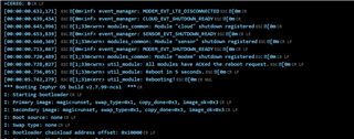

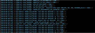

problem in connecting nRF9160 DK with nRF cloud
Recently I purchased nRF9160 DK and I have a Vodafone Idea SIM (active). I followed the instructions precisely as per the Nordic infocenter but I am not able to connect my nRF9160DK to the nRF cloud. I tried to upload the latest modem and application firmware in the DK and 4 LEDs started blinking simultaneously after that. When I checked LTE link monitor the DK was rebooting every 5 seconds. As specified in the Nordic documentation I tried updating the certificate after the AT commands. Then I tried inserting the SIM card but LED1 was blinking instead of LED3. The LTE is not connecting as well even after waiting for several minutes. The sequence is --- LED1>LED2>LED4>LED2
I don't know whether it is the problem with DK or the problem with SIM
Can anyone please help me with this issue. I am attaching images for the reference.

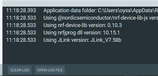

    Can you please provide the log in text format? You can find this at the bottom of LTE Link Monitor as "Open Log File".

  • Can you please provide the log in text format? You can find this at the bottom of LTE Link Monitor as "Open Log File".
    2022-02-25T10:35:22.223Z INFO Application data folder: C:\Users\vishn\AppData\Roaming\nrfconnect\pc-nrfconnect-linkmonitor
    2022-02-25T10:35:22.299Z DEBUG App pc-nrfconnect-linkmonitor v2.0.0 official
    2022-02-25T10:35:22.299Z DEBUG App path: C:\Users\vishn\.nrfconnect-apps\node_modules\pc-nrfconnect-linkmonitor
    2022-02-25T10:35:22.299Z DEBUG nRFConnect 3.10.0, required by the app is (^3.8.0)
    2022-02-25T10:35:22.299Z DEBUG nRFConnect path: C:\Users\vishn\AppData\Local\Programs\nrfconnect\resources\app.asar
    2022-02-25T10:35:22.299Z DEBUG HomeDir: C:\Users\vishn
    2022-02-25T10:35:22.299Z DEBUG TmpDir: C:\Users\vishn\AppData\Local\Temp
    2022-02-25T10:35:30.043Z INFO Modem port is opened
    2022-02-25T10:35:46.212Z INFO Modem port is closed
    2022-02-25T10:35:46.225Z INFO Modem port is opened
    2022-02-25T10:35:58.982Z DEBUG modem >> AT+CFUN=4
    2022-02-25T10:35:59.984Z ERROR Error: 'AT+CFUN=4
    ' timed out

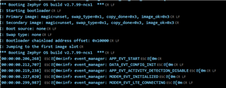

    2022-02-25T10:36:06.924Z DEBUG modem << *** Booting Zephyr OS build v2.7.99-ncs1 ***
    2022-02-25T10:36:06.933Z DEBUG modem << I: Starting bootloader
    2022-02-25T10:36:06.936Z DEBUG modem << I: Primary image: magic=unset, swap_type=0x1, copy_done=0x3, image_ok=0x3
    2022-02-25T10:36:06.939Z DEBUG modem << I: Secondary image: magic=unset, swap_type=0x1, copy_done=0x3, image_ok=0x3
    2022-02-25T10:36:06.945Z DEBUG modem << I: Boot source: none
    2022-02-25T10:36:06.952Z DEBUG modem << I: Swap type: none
    2022-02-25T10:36:07.031Z DEBUG modem << I: Bootloader chainload address offset: 0x10000
    2022-02-25T10:36:07.039Z DEBUG modem << I: Jumping to the first image slot
    2022-02-25T10:36:07.508Z DEBUG modem << *** Booting Zephyr OS build v2.7.99-ncs1 ***
    2022-02-25T10:36:07.515Z DEBUG modem << [00:00:00.206,268] [0m<inf> event_manager: APP_EVT_START[0m
    2022-02-25T10:36:07.577Z DEBUG modem << [00:00:00.212,707] [0m<inf> event_manager: DATA_EVT_CONFIG_INIT[0m
    2022-02-25T10:36:07.579Z DEBUG modem << [00:00:00.219,238] [0m<inf> event_manager: APP_EVT_ACTIVITY_DETECTION_DISABLE[0m
    2022-02-25T10:36:07.581Z DEBUG modem << [00:00:00.227,020] [0m<inf> event_manager: MODEM_EVT_INITIALIZED[0m
    2022-02-25T10:36:07.607Z DEBUG modem << [00:00:00.299,774] [0m<inf> event_manager: MODEM_EVT_LTE_CONNECTING[0m
    2022-02-25T10:36:07.847Z DEBUG modem << +CEREG: 90
    2022-02-25T10:36:07.868Z DEBUG modem << [00:00:00.546,051] [1;31m<err> modem_module: No SIM card detected![0m
    2022-02-25T10:36:07.870Z DEBUG modem << [00:00:00.552,459] [0m<inf> event_manager: MODEM_EVT_ERROR - Error code -134[0m
    2022-02-25T10:36:07.872Z DEBUG modem << [00:00:00.560,180] [0m<inf> event_manager: MODEM_EVT_LTE_CELL_UPDATE[0m
    2022-02-25T10:36:07.883Z DEBUG modem << [00:00:00.567,138] [0m<inf> event_manager: UTIL_EVT_SHUTDOWN_REQUEST[0m
    2022-02-25T10:36:07.885Z DEBUG modem << [00:00:00.574,127] [0m<inf> event_manager: UI_EVT_SHUTDOWN_READY[0m
    2022-02-25T10:36:07.888Z DEBUG modem << [00:00:00.580,291] [1;33m<wrn> modules_common: Module "ui" shutdown registered[0m
    2022-02-25T10:36:07.900Z DEBUG modem << [00:00:00.587,646] [0m<inf> event_manager: GNSS_EVT_SHUTDOWN_READY[0m
    2022-02-25T10:36:07.902Z DEBUG modem << [00:00:00.594,055] [1;33m<wrn> modules_common: Module "gnss" shutdown registered[0m
    2022-02-25T10:36:07.913Z DEBUG modem << [00:00:00.602,142] [0m<inf> event_manager: APP_EVT_SHUTDOWN_READY[0m
    2022-02-25T10:36:07.917Z DEBUG modem << [00:00:00.608,398] [1;33m<wrn> modules_common: Module "app" shutdown registered[0m
    2022-02-25T10:36:07.929Z DEBUG modem << [00:00:00.616,607] [0m<inf> event_manager: DATA_EVT_SHUTDOWN_READY[0m
    2022-02-25T10:36:07.933Z DEBUG modem << [00:00:00.622,924] [1;33m<wrn> modules_common: Module "data" shutdown registered[0m
    2022-02-25T10:36:07.935Z DEBUG modem << +CEREG: 0
    2022-02-25T10:36:07.947Z DEBUG modem << [00:00:00.631,988] [0m<inf> event_manager: MODEM_EVT_LTE_DISCONNECTED[0m
    2022-02-25T10:36:07.950Z DEBUG modem << [00:00:00.639,221] [0m<inf> event_manager: CLOUD_EVT_SHUTDOWN_READY[0m
    2022-02-25T10:36:07.955Z DEBUG modem << [00:00:00.645,812] [1;33m<wrn> modules_common: Module "cloud" shutdown registered[0m
    2022-02-25T10:36:07.964Z DEBUG modem << [00:00:00.653,625] [0m<inf> event_manager: SENSOR_EVT_SHUTDOWN_READY[0m
    2022-02-25T10:36:07.969Z DEBUG modem << [00:00:00.660,156] [1;33m<wrn> modules_common: Module "sensor" shutdown registered[0m
    2022-02-25T10:36:08.021Z DEBUG modem << [00:00:00.713,684] [0m<inf> event_manager: MODEM_EVT_SHUTDOWN_READY[0m
    2022-02-25T10:36:08.029Z DEBUG modem << [00:00:00.720,306] [1;33m<wrn> modules_common: Module "modem" shutdown registered[0m
    2022-02-25T10:36:08.037Z DEBUG modem << [00:00:00.727,844] [1;33m<wrn> util_module: All modules have ACKed the reboot request.[0m
    2022-02-25T10:36:08.043Z DEBUG modem << [00:00:00.735,839] [1;33m<wrn> util_module: Reboot in 5 seconds.[0m

    2022-02-25T10:37:02.082Z DEBUG modem << [00:00:02.028,350] [1;33m<wrn> util_module: All modules have ACKed the reboot request.[0m
    2022-02-25T10:37:02.084Z DEBUG modem << [00:00:02.036,346] [1;33m<wrn> util_module: Reboot in 5 seconds.[0m
    2022-02-25T10:37:07.090Z DEBUG modem << [00:00:07.042,572] [1;31m<err> util_module: Rebooting![0m
    2022-02-25T10:37:07.345Z DEBUG modem << *** Booting Zephyr OS build v2.7.99-ncs1 ***
    2022-02-25T10:37:07.348Z DEBUG modem << I: Starting bootloader
    2022-02-25T10:37:07.354Z DEBUG modem << I: Primary image: magic=unset, swap_type=0x1, copy_done=0x3, image_ok=0x3
    2022-02-25T10:37:07.364Z DEBUG modem << I: Secondary image: magic=unset, swap_type=0x1, copy_done=0x3, image_ok=0x3
    2022-02-25T10:37:07.365Z DEBUG modem << I: Boot source: none
    2022-02-25T10:37:07.366Z DEBUG modem << I: Swap type: none
    2022-02-25T10:37:07.453Z DEBUG modem << I: Bootloader chainload address offset: 0x10000
    2022-02-25T10:37:07.463Z DEBUG modem << I: Jumping to the first image slot
    2022-02-25T10:37:07.929Z DEBUG modem << *** Booting Zephyr OS build v2.7.99-ncs1 ***
    2022-02-25T10:37:07.935Z DEBUG modem << [00:00:00.206,237] [0m<inf> event_manager: APP_EVT_START[0m
    2022-02-25T10:37:07.947Z DEBUG modem << [00:00:00.212,677] [0m<inf> event_manager: DATA_EVT_CONFIG_INIT[0m
    2022-02-25T10:37:07.949Z DEBUG modem << [00:00:00.219,207] [0m<inf> event_manager: APP_EVT_ACTIVITY_DETECTION_DISABLE[0m
    2022-02-25T10:37:07.956Z DEBUG modem << [00:00:00.226,989] [0m<inf> event_manager: MODEM_EVT_INITIALIZED[0m
    2022-02-25T10:37:08.029Z DEBUG modem << [00:00:00.299,804] [0m<inf> event_manager: MODEM_EVT_LTE_CONNECTING[0m
    2022-02-25T10:37:08.269Z DEBUG modem << +CEREG: 90
    2022-02-25T10:37:08.284Z DEBUG modem << [00:00:00.546,081] [1;31m<err> modem_module: No SIM card detected![0m
    2022-02-25T10:37:08.286Z DEBUG modem << [00:00:00.552,520] [0m<inf> event_manager: MODEM_EVT_ERROR - Error code -134[0m
    2022-02-25T10:37:08.302Z DEBUG modem << [00:00:00.560,241] [0m<inf> event_manager: MODEM_EVT_LTE_CELL_UPDATE[0m
    2022-02-25T10:37:08.304Z DEBUG modem << [00:00:00.567,199] [0m<inf> event_manager: UTIL_EVT_SHUTDOWN_REQUEST[0m
    2022-02-25T10:37:08.306Z DEBUG modem << [00:00:00.574,188] [0m<inf> event_manager: UI_EVT_SHUTDOWN_READY[0m
    2022-02-25T10:37:08.320Z DEBUG modem << [00:00:00.580,352] [1;33m<wrn> modules_common: Module "ui" shutdown registered[0m
    2022-02-25T10:37:08.322Z DEBUG modem << [00:00:00.587,738] [0m<inf> event_manager: GNSS_EVT_SHUTDOWN_READY[0m
    2022-02-25T10:37:08.336Z DEBUG modem << [00:00:00.594,146] [1;33m<wrn> modules_common: Module "gnss" shutdown registered[0m
    2022-02-25T10:37:08.337Z DEBUG modem << [00:00:00.602,203] [0m<inf> event_manager: APP_EVT_SHUTDOWN_READY[0m
    2022-02-25T10:37:08.350Z DEBUG modem << [00:00:00.608,459] [1;33m<wrn> modules_common: Module "app" shutdown registered[0m
    2022-02-25T10:37:08.353Z DEBUG modem << [00:00:00.616,638] [0m<inf> event_manager: DATA_EVT_SHUTDOWN_READY[0m
    2022-02-25T10:37:08.356Z DEBUG modem << [00:00:00.623,016] [1;33m<wrn> modules_common: Module "data" shutdown registered[0m
    2022-02-25T10:37:08.358Z DEBUG modem << +CEREG: 0
    2022-02-25T10:37:08.372Z DEBUG modem << [00:00:00.632,049] [0m<inf> event_manager: MODEM_EVT_LTE_DISCONNECTED[0m
    2022-02-25T10:37:08.384Z DEBUG modem << [00:00:00.639,282] [0m<inf> event_manager: CLOUD_EVT_SHUTDOWN_READY[0m
    2022-02-25T10:37:08.388Z DEBUG modem << [00:00:00.645,874] [1;33m<wrn> modules_common: Module "cloud" shutdown registered[0m
    2022-02-25T10:37:08.389Z DEBUG modem << [00:00:00.653,686] [0m<inf> event_manager: SENSOR_EVT_SHUTDOWN_READY[0m
    2022-02-25T10:37:08.402Z DEBUG modem << [00:00:00.660,186] [1;33m<wrn> modules_common: Module "sensor" shutdown registered[0m
    2022-02-25T10:37:08.443Z DEBUG modem << [00:00:00.713,745] [0m<inf> event_manager: MODEM_EVT_SHUTDOWN_READY[0m
    2022-02-25T10:37:08.451Z DEBUG modem << [00:00:00.720,367] [1;33m<wrn> modules_common: Module "modem" shutdown registered[0m
    2022-02-25T10:37:08.464Z DEBUG modem << [00:00:00.727,905] [1;33m<wrn> util_module: All modules have ACKed the reboot request.[0m
    2022-02-25T10:37:08.466Z DEBUG modem << [00:00:00.735,900] [1;33m<wrn> util_module: Reboot in 5 seconds.[0m
    2022-02-25T10:37:10.593Z DEBUG modem << *** Booting Zephyr OS build v2.7.99-ncs1 ***
    2022-02-25T10:37:10.597Z DEBUG modem << I: Starting bootloader
    2022-02-25T10:37:10.601Z DEBUG modem << I: Primary image: magic=unset, swap_type=0x1, copy_done=0x3, image_ok=0x3
    2022-02-25T10:37:10.613Z DEBUG modem << I: Secondary image: magic=unset, swap_type=0x1, copy_done=0x3, image_ok=0x3
    2022-02-25T10:37:10.615Z DEBUG modem << I: Boot source: none
    2022-02-25T10:37:10.616Z DEBUG modem << I: Swap type: none
    2022-02-25T10:37:10.701Z DEBUG modem << I: Bootloader chainload address offset: 0x10000
    2022-02-25T10:37:10.703Z DEBUG modem << I: Jumping to the first image slot
    2022-02-25T10:37:11.176Z DEBUG modem << *** Booting Zephyr OS build v2.7.99-ncs1 ***
    2022-02-25T10:37:11.181Z DEBUG modem << [00:00:00.206,237] [0m<inf> event_manager: APP_EVT_START[0m
    2022-02-25T10:37:11.189Z DEBUG modem << [00:00:00.212,677] [0m<inf> event_manager: DATA_EVT_CONFIG_INIT[0m
    2022-02-25T10:37:11.199Z DEBUG modem << [00:00:00.219,177] [0m<inf> event_manager: APP_EVT_ACTIVITY_DETECTION_DISABLE[0m
    2022-02-25T10:37:11.203Z DEBUG modem << [00:00:00.226,928] [0m<inf> event_manager: MODEM_EVT_INITIALIZED[0m
    2022-02-25T10:37:11.277Z DEBUG modem << [00:00:00.299,713] [0m<inf> event_manager: MODEM_EVT_LTE_CONNECTING[0m
