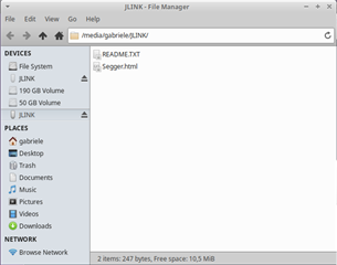

When I hook the nRF5340-DK board to my PC, the SEGGER J-Link OB debug chip bothers me popping up a GUI that exposes the board as a USB mass storage device.
How to get it disabled persistently ?

Hi Priyanka,
I prefer the following "soft" solution
1. Connect the J-Link-OB target to PC
2. Start J-Link Commander
3. execute the command
J-Link > msddisable
4. Quit J-Link Commander
In order to restore the MSD functionality, the command is 'msdenable'
