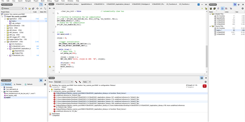

  • Hello Jered
    I have just realized that I need to write the code from scratch :) so here is the start...
    The problem I am having is now to discern between the master and slave, is there a particular #include for the master i2c or it is part of the regular #include? For example, the code below stops exactly at the ' m_twi ', see below:
    // nRF52DK
    #ifdef nRF52DK
      #include "VCNL4035X01.h"
      #include "nrf_drv_twi.h"
      #include <hal/nrf_twim.h>
    // please ensure that the restart conditition is implemented corretly for the I2C read command, what does that mean...
    int WriteI2C_Bus(struct TransferData *Data) {
      // A flag to indicate the transfer state
      static volatile bool m_xfer_done_1 = false;
      // initialization of initial error = 0
      int Error = 0;
      // Define an array of 3 Bytes to be sent as I2C Write Command as shown in Fig. 10 in the Datasheet Page 7
      uint8_t WData[3] = {Data->RegisterAddress, Data->WData[0], Data->WData[1]};
      // Send I2C Write Command as shown in Fig. 10 in the Datasheet Page 7 with Error checking.
      //Error = ...
      int8_t twi_write(uint8_t dev_addr, uint8_t reg_addr, uint8_t * data, uint16_t length) {
        uint32_t err_code;
        uint8_t buffer[255] = {0};
        buffer[0] = reg_addr;
        memcpy(&buffer[1], data, length);
        err_code = nrf_drv_twi_tx(&m_twi, dev_addr, buffer, sizeof(length), false);
        while (m_xfer_done_1 == false);
        return err_code;
    //the read function...
    Any help is very much appreciated.
    PS indeed, I am following the example of the STM32.

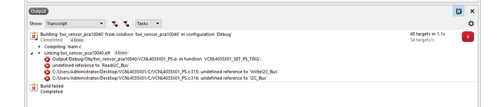

  • I have sorted the above problem... the problem was in the actual declaration of variables. drivers... For example, once the drivers, variables were added to the #ifdef ... #endif clause, then it compiles ok.
    However, I am not happy with that answer , would somebody please explain why is this not possible to do in the main.c ? For example, at early beginning, just after the include, etc. What is the way to sort this out globally?
