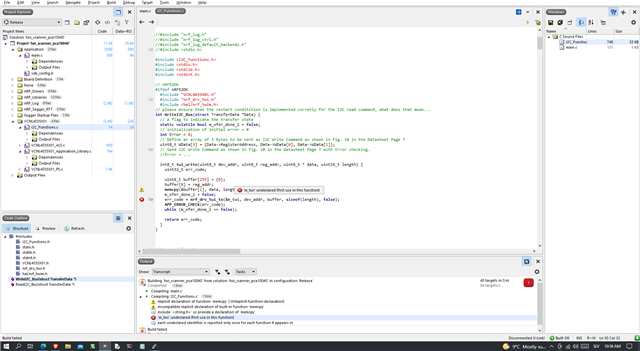

  • Hello Jered
    I have just realized that I need to write the code from scratch :) so here is the start...
    The problem I am having is now to discern between the master and slave, is there a particular #include for the master i2c or it is part of the regular #include? For example, the code below stops exactly at the ' m_twi ', see below:

  • I have sorted the above problem... the problem was in the actual declaration of variables. drivers... For example, once the drivers, variables were added to the #ifdef ... #endif clause, then it compiles ok.
    However, I am not happy with that answer , would somebody please explain why is this not possible to do in the main.c ? For example, at early beginning, just after the include, etc. What is the way to sort this out globally?
