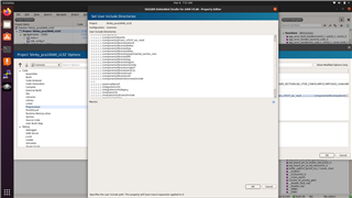

I am trying to code to print data on UART so I have added below folder path into user include directories:
../../../config
../../../../../../components
../../../../../../components/boards
../../../../../../components/drivers_nrf/nrf_soc_nosd
../../../../../../components/libraries/atomic
../../../../../../components/libraries/balloc
../../../../../../components/libraries/bsp
../../../../../../components/libraries/delay
../../../../../../components/libraries/experimental_section_vars
../../../../../../components/libraries/fifo
../../../../../../components/libraries/log
../../../../../../components/libraries/log/src
../../../../../../components/libraries/memobj
../../../../../../components/libraries/ringbuf
../../../../../../components/libraries/strerror
../../../../../../components/libraries/uart
../../../../../../components/libraries/util
../../../../../../components/toolchain/cmsis/include
../../../../../../external/fprintf
../../../../../../integration/nrfx
../../../../../../integration/nrfx/legacy
../../../../../../modules/nrfx
../../../../../../modules/nrfx/drivers/include
../../../../../../modules/nrfx/hal
../../../../../../modules/nrfx/mdk
../config

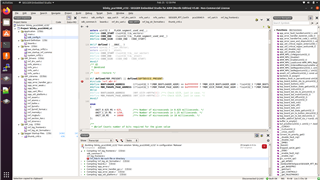

Also, I have added the required file to the project but still, I am getting the error below.
Compiling 'nrf_log_frontend.c'
sdk_common.h
nrf_log_frontend.c
nrf_mbr.h: No such file or directory
What is SOFTDEVICE_PRESENT and where it is defined in SEGGER?

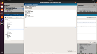

    SOFTDEVICE_PRESENT is a preprocessor definition that tells the compiler to include softdevice specific files. For example, here is the preprocessor definitions for the ble_app_blinky project in the SDK which uses the Softedevice stack:
  • Thanks for your reply.

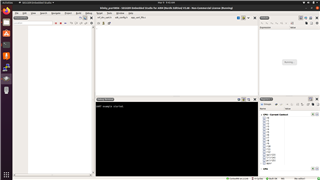

    I tried to remove SOFTDEVICE_PRESENT from the preprocessor definition it got compiled successfully. But instead of the printing message on UART / Terminal Emulator, it is getting printed on Debug terminal, where usually I believe RTT log is getting printed.
    What is remaining? Can you please help?

    Here is the screenshot of the building successful at my end.
    For you, I have collapsed all folders at left project explorer.
    Attaching a Screenshot of the User include directories.
    Also attaching a screenshot of Preprocessor definition

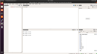

    I have checked with PCA10056 as you can see in the screenshot at the top (Written PCA10056). But behavior is similar like before.

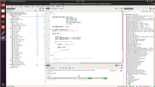

    I found the problem there was 1 file that needs to be included in nRF_Libraries folder that is retarget.c kept in nRF5_SDK_17.0.2_d674dde/components/libraries/uart/retarget.c
    Maybe I assume this retarget.c file is necessary to indicate that LOG should print on UART instead of Debug terminal (Where generally RTT LOG is getting displayed).
    Thank you so much Jared for your help. Got so much input from you. Really Appreciated.
