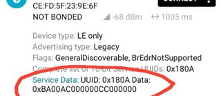

advertise the sensor data continuously and connectable in service data format
i am using nrf52810 with mpu6050 for reading accelerometer and gyro-meter data and i want to advertise the sensor data continuously in nrf mobile application where the sensor data updated continuously for every second , and also its connectable to change the angle of it. if i used beacon example its only advertise and non-connectable . so i need advertise as below format and if anybody have any suggestions or reference please share me to resolve this problem .
 thank you.
  • Hello Sagarnayakm,
                                   I have a template example which is updating advertising data and connectable .
                                 I am sharing here if it may help you .

    #define DEVICE_NAME                     "Nordic_Template"                       /**< Name of device. Will be included in the advertising data. */
    #define MANUFACTURER_NAME               "NordicSemiconductor"                   /**< Manufacturer. Will be passed to Device Information Service. */
    #define APP_ADV_INTERVAL                1600                                    /**< The advertising interval (in units of 0.625 ms. This value corresponds to 187.5 ms). */
    #define APP_ADV_DURATION                18000                                   /**< The advertising duration (180 seconds) in units of 10 milliseconds. */
    #define APP_BLE_OBSERVER_PRIO           3                                       /**< Application's BLE observer priority. You shouldn't need to modify this value. */
    #define APP_BLE_CONN_CFG_TAG            1                                       /**< A tag identifying the SoftDevice BLE configuration. */

    APP_TIMER_DEF(m_adv_data_update_timer);
    #define ADV_DATA_UPDATE_INTERVAL        APP_TIMER_TICKS(5000L)
    #define MANUF_PAYLOAD_1                 0x4E    // N
    #define MANUF_PAYLOAD_2                 0x4F    // O
    #define MANUF_PAYLOAD_3                 0x52    // R
    #define MANUF_PAYLOAD_4                 0x44    // D
    #define MANUF_PAYLOAD_5                 0x49    // I
    #define MANUF_PAYLOAD_6                 0x43    // C
    #define PAYLOAD_SIZE                    1
    #define TOP_INDEX                       5
    #define APP_COMPANY_IDENTIFIER          0x0059                                  /**< Company identifier for Nordic Semiconductor ASA. as per www.bluetooth.org. */
    static ble_advdata_t                    new_advdata;
    static uint8_t manufacturing_data_payload_list [] =
        MANUF_PAYLOAD_1,
        MANUF_PAYLOAD_2,
        MANUF_PAYLOAD_3,
        MANUF_PAYLOAD_4,
        MANUF_PAYLOAD_5,
        MANUF_PAYLOAD_6
    static void advertising_start(bool erase_bonds);
    /**@brief Callback function for asserts in the SoftDevice.
     * @param[in] line_num   Line number of the failing ASSERT call.
     * @param[in] file_name  File name of the failing ASSERT call.
    static void adv_data_update_timer_handler(void * p_context)
        ret_code_t                  err_code;
        ble_advdata_manuf_data_t    manuf_data;
        new_advdata.p_manuf_specific_data = &manuf_data;
        static uint8_t payload_index = 0;
        NRF_LOG_INFO("Updating advertising data!");
        manuf_data.company_identifier = APP_COMPANY_IDENTIFIER;
        manuf_data.data.p_data = manufacturing_data_payload_list + payload_index;
        manuf_data.data.size = PAYLOAD_SIZE;
        err_code = ble_advertising_advdata_update(&m_advertising, &new_advdata, NULL);
        if(payload_index == TOP_INDEX)
            payload_index = 0;
        else
            payload_index++;
        NRF_LOG_INFO("Advertising data updated!");

    Thanks for the reply, i will try and let knowSmiley
    i can able to advertise the sensor data in the nrf mobile application in service format only once like using payload but updating the sensor data is not possible so for more details please feel free to check  the below attachment .
    thank you.
    Are you saying that you are unable to update the characteristic's data, is this your issue?
    I recommend going through this tutorial on services and characteristics, and for example create a read service (if you will not be using notifications) which you then update with the sensor data.
    If this what not what you were asking about, please elaborate on your current issue.
