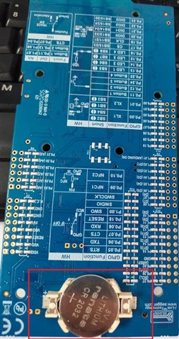

    I am glad too, to hear from you, and sorry for disturbing you. Sir, I have a question regarding the Button battery which are on the backside of the NRF52840 Development board, as you can see in the attached picture. The question is what is the purpose of that button battery ? Is it used for an external RTC or Internal RTC can also operate on that cell?
  • The internal RTC can operate on this battery as well. Just switch the SW9 power switch to battery powered, then this coin cell battery will be used instead.
    The RTC is internal to the nRF52840, so the entire nRF52840 will need to be powered for the RTC to function.
    Karl
