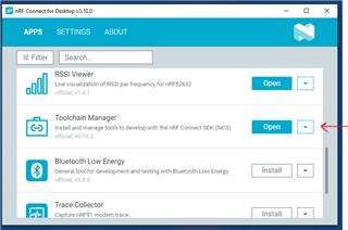

    So first off, try to get familiar whit the nRF Connect SDK(NCS) and decide if you want to use SEGGER or VS Code to do the build\compile, we do have some getting started guides here:https://developer.nordicsemi.com/nRF_Connect_SDK/doc/1.7.0/nrf/getting_started.html#
    I would recommend that you install the nRF Connect for desktop application and use the toolchain manager, from there you can launched either SEGGER or VS code as the IDE.
    You can install packages form other sources at the bottom, so then you can use the fork that peepee-boy has.
