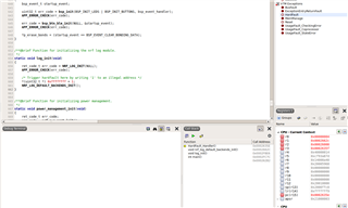

I have been programming my custom board using SWD on a DK. It worked fine when I tried blinky example, however, when I tried nrf_ble_uart example, it stopped at the log_init():
and when I break it, it showed in HardFault_handle() :
I tried several solution in the devzone but none of them solved this problem. The circuit only had  MDBT42Q chip with GND and VDD SWDCLK and SWDIO pins connected.

    It's strange that you seem to be getting a fault exception from the log_init() call. When the ble_app_uart example does not run on a custom board it's usually one of two things: Either the wrong 32 KHz clock source is selected, or a floating UART RX input that causes the APP_UART_COMMUNICATION_ERROR event to be raised. But neither of these should trigger a fault exception.
    Does the exact same code run fine on your DK? And can you post a screenshot that includes the CPU registers and call stack  as well?

    Here is the screenshot

  • Hi Chris,
    The stack pointer (SP) value is suspiciously low in your case - it should never go below 0x2000e000 with the default 'pca10040' project configuration. But I'm not sure why this only happens on the custom board. Did you make any changes to the ble_app_uart example?
    You can see from the screenshot below what the default RAM layout is for the ble_app_uart_pca10040_s132 project in sdk 17.1.0. The valid address range for the stack pointer is defined by the .stack region.
    Do you get the same exception if you set the NRF_LOG_ENABLED symbol in sdk_config.h to '0'? Also, what is the SP value when you reach main() on startup before log_init()?
    Here is what the call stack and register view may look like after a hardfault expception has been raised in log_init():
