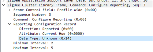

    I found the problem in my "zcl subscribe on" command.  I was not specifying the correct type.  I did not realize that the response to my earlier attribute queries included the attribute type in hexadecimal while the "subscribe on" command wants the attribute type in DECIMAL.  Anyway, it looks like it's working, sort of.  Should I get a report every time that the subscribed attribute changes?  I'm only seeing one report after I subscribe.

    I figured out what the issue was. You must use the decimal value for the attr_type in the subscribe on command, and not the hexadecimal value:
    zcl subscribe on h:addr d:ep h:cluster h:profile h:attr_id d:attr_type [d:min interval (s)] [d:max interval (s)]
    When you send the command with attr_type set to 20, you actually send that the data type of the attribute is 0x14, which is the value for 56-bit data type:

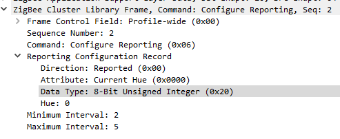

    For current hue you should instead use 32 as attr_type:
    zcl subscribe on 3e2d 11 0x0300 0x0104 0x00 32 2 5
    This will send the command with 8-bit unsigned int as data type, which is the correct one for current hue:
    This picture is from a sniffer log I captured where I successfully subscribed on the current hue attribute.
