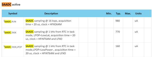

    1. Sampling digital signals using the SAAD and timer should be possible, technically. You just need to decode the analog samples as high or low level based on sampled value. For example: sampled value above 0.7xVDD is for high and below 0.3xVDD is for low.
    If you want data from multiple GPIO pins, you need to consider that there is only on ADC core, so sampling multiple analog inputs will happen sequentially (SCAN mode). Then there will be (T_acq + T_conv) ''delay'' between samples from each input. One thing, you have to consider that SADDC is quite high power (see the table below from our product electrical specification) when it
    is active.
    Therefore it would not be a low power operation if this is you want to implement, not involving the CPU.
