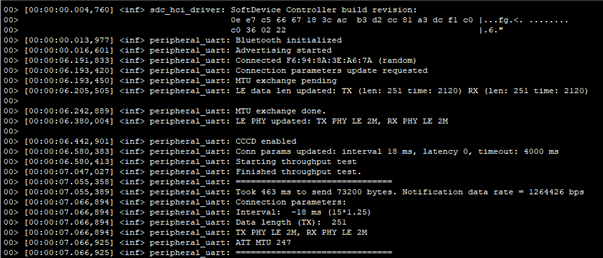

    I also attached my own data throughput sample that based on the peripheral_uart sample. You can simply test the throughput using a phone or any central. Just need to enable notification CCCD to start the test.
    In the log you can see something like this:

  • Hi Hichem,
    From the logs I can see that the central support 251 bytes datalength but the slave was responding with only 27 bytes.
    I suspect that the hci_rpmsg was not compiled with the updated value of the datalength.
    I would suggest to try compile the hci_rpmsg separately (with 251 bytes datalength configuration in the prj.conf) and flash it separately into the netcore.
    Please make sure you erased the netcore before the test. If you use nrfjprog you would need to use "--coprocessor CP_NETWORK"
    I would suggest to test with our throughput sample in the SDK and capture a sniffer trace to see if Datalength is updated correctly.
    0486.peripheral_uart_throughput.zip
