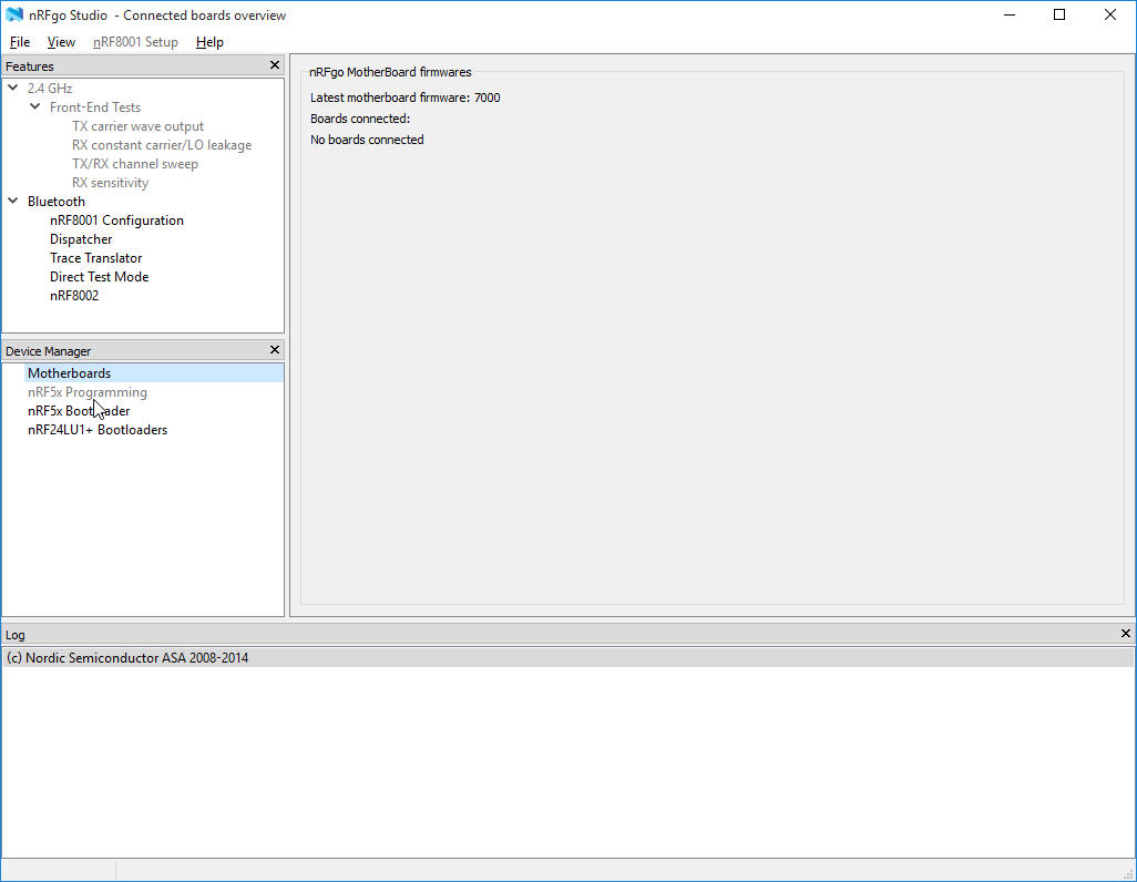

nRFgo Studio does not see my nRF51-DK anymore
I run a laptop which previously ran this fine on Windows 7 x64. I now run Windows 10 x64. I cleaned out j-link, nrfgo studio, libusb etc and reinstalled nRFgo Studio again to be sure. The version is 1.20.0. www.nordicsemi.com/.../65589710
This is how it looks now:

image description
I guess that won't make a difference as for detecting it in nRFgo
