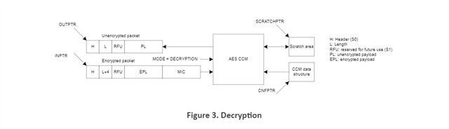

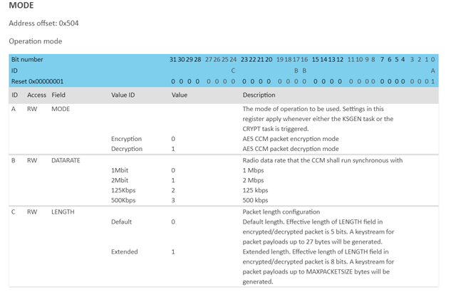

I have found that error free decryption ( MIC error) on fly depends from S1LEN configuration value.
S1LEN have valid range value for each radio mode
2Mbit   1-8
1Mbit   1-6 bit
500K  1-6
125K  1 only
So I have set it to 1 and it work in all radio modes.
Can you explain what is role of S1 byte for triggering decryption on fly  ?
Is any connection of it with preconfigured PPI channel 25 ?
NRF_PPI->CHEN |= (1UL << NRF_PPI_CHANNEL25);
what trigger decrypt process.
