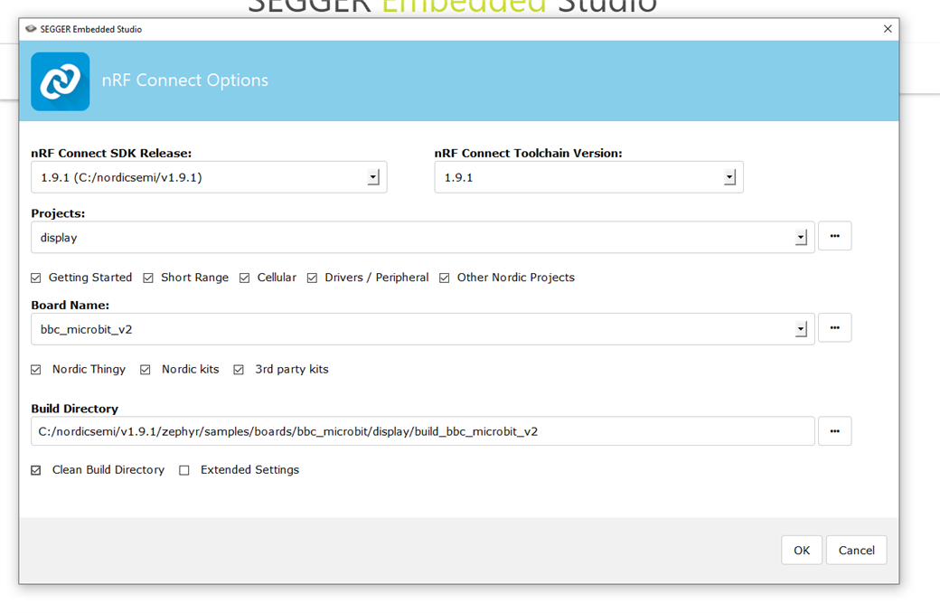

  • Hi Mike,
    The display driver(CONFIG_DISPLAY) https://docs.zephyrproject.org/latest/reference/display/index.html has support for the Micro:bit v2 (CONFIG_MICROBIT_DISPLAY). Try out this sample
