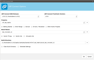

So far, so good.  But now I want to use the 5x5 LED matrix on the Micro:Bit, instead of the one or two single LEDs typically found on Nordic dev boards.  Interestingly, there's even sample code in the Zephyr system to support this task, explicitly labeled nRF LED Matrix,, which purports to what I want and it's even included in the Zephyr repo in the nRF SDK!  But, alas, it doesn't seem to be accessible to me from the SES "Open nRF Connect SDK Project..." path.  Using that wizard, the Projects selector (slow, unresponsive, prone to crashing!) doesn't allow me to get at the requisite "nRF LED Matrix" sample app.  (Trying to install a separate Zephyr build environment off to the side for experimentation is its own tar pit, e.g., involving all kinds of Python version conflicts and west problems, at least in macOS).  And the sample code and this part of the Zephyr library(?) may not be directly useful, since it's C++ code and dependent on Zephyr low-level support. a different build model, etc..

    I opened the nRF LED Matrix sample from zephyr\samples\boards\nrf\nrf_led_matrix to use with zephyr\boards\arm\bbc_microbit_v2
    And building the sample seems to work as intended as well.

    Many thanks. Yes, the sample did build, compile, and load onto my Micro:Bit V2 and execute correctly (at least with lots of flashing LED patterns :-)
    The critical issue for me was that I was being too restrictive in following the instructions for specifying a project in the "File → Open nRF Connect SDK Project" wizard.  I was only using the triangle selector to look for available project, thus not finding "nrf_led_matrix".  I didn't realize that the additional projects in the zephyr repo were available as Custom" projects and could be accessed via the normal  ... file browser.
    Suggestion: Perhaps the documentation in the "Toolchain Manager | First steps | Building with SEGGER Embedded Studio | 3. | Projects" could be clarified to include two facts.
    1. The projects in the Zephyr repo are accessible as "custom" projects using the file finder.
    2. To be considered a custom project, the project must conform to the rules proscribed in the Zephyr docs for project structure (or whatever the defining documentation is).
