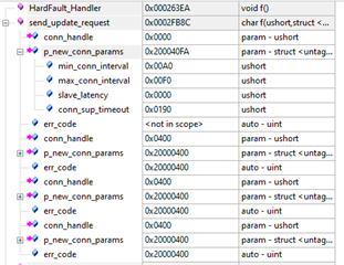

  • Hello, I am on SDK15.
    In the execution I se this :
    I tried to change the send_update_request function but even with NRF_LOG and breakpoints i can't get the actual error
    static bool send_update_request(uint16_t conn_handle, ble_gap_conn_params_t * p_new_conn_params)
        ret_code_t err_code;
        err_code = sd_ble_gap_conn_param_update(conn_handle, p_new_conn_params);
    		if(err_code == NRF_ERROR_INVALID_ADDR)
    			NRF_LOG_INFO("NRF_ERROR_INVALID_ADDR");
    		if (err_code == NRF_ERROR_INVALID_PARAM)
    			NRF_LOG_INFO("NRF_ERROR_INVALID_PARAM");
    		if (err_code == NRF_ERROR_INVALID_STATE)
    			NRF_LOG_INFO("NRF_ERROR_INVALID_STATE");
    		if (err_code == BLE_ERROR_INVALID_CONN_HANDLE)
    			NRF_LOG_INFO("BLE_ERROR_INVALID_CONN_HANDLE");
    		if (err_code == NRF_ERROR_NO_MEM)
    			NRF_LOG_INFO("NRF_ERROR_NO_MEM");
    		NRF_LOG_FLUSH();
        if ((err_code != NRF_SUCCESS) && (err_code != NRF_ERROR_BUSY)) // NRF_ERROR_BUSY means another conn_param_update request is pending.
            send_error_evt(err_code);
    		return true;
        return (err_code == NRF_SUCCESS);
    Thanks. So the p_new_conne_params pointer is NULL for some reason. That explains the hardfault at least. Please place a breakpoint in ble_conn_params.c::ble_evt_handler() to see if it gets called on the BLE_GAP_EVT_CONNECTED event.

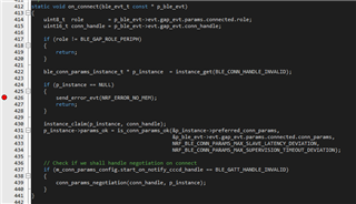

  • Hello, i checked i go through on_connect in ble_conn_params.c and i do call ble_conn_params_init.
    Strange. Are you able to debug the ble_conn_params.c::instance_get() function to check why it's returning null?
  • i've aded a breakpoint here :
    and the code does't reach. I tried again with a breakpoint at the beguining and did a step by step debug and the p_instance isn't NULL.
    sd_ble_gap_conn_param_update needs a call to instance_get ?
