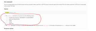

case about nrf9160 ncs v1.9.0 example: serial_lte_modem #XTCPSEND
dk: PCA10090 0.9.0 2019.21
ncs: v1.9.0
How to send HEX data to the server with the command #XTCPSEND at ncs v1.9.0
the old sdk ncs v1.8.0 example is like this
at#xtcpsend=1,"7E01000025056109427727000100000000000000000000000000000000000000000000000000000000003934323737323700607E"
Thank you for all your assistance.
