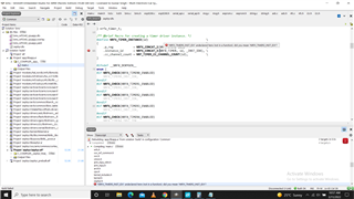

  • I copied some code from the link of example given by you as in attached text file. When, build the error shown in image occurs.

  • Try these timer instances instead:
    static const nrfx_timer_t m_timer_count = NRFX_TIMER_INSTANCE(2);
    static const nrfx_timer_t m_timer_read  = NRFX_TIMER_INSTANCE(3);
    And set this in prj.conf
    CONFIG_NRFX_TIMER2=y
    CONFIG_NRFX_TIMER3=y
