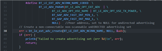

            // Non-connectable extended advertising with @ref BT_LE_ADV_OPT_USE_NAME BT_LE_ADV_OPT_CODED
           #define BT_LE_EXT_ADV_NCONN_NAME_CODED  BT_LE_ADV_PARAM(BT_LE_ADV_OPT_EXT_ADV | \
    						 BT_LE_ADV_OPT_USE_NAME | BT_LE_ADV_OPT_USE_TX_POWER | \
                                                     BT_LE_ADV_OPT_CODED, \
    						 BT_GAP_ADV_FAST_INT_MIN_1, \
    						 BT_GAP_ADV_FAST_INT_MAX_1, \
    						 NULL)   //Peer address, set to NULL for undirected advertising
    	// Create a non-connectable non-scannable unDIRECTED advertising set
    	err = bt_le_ext_adv_create(BT_LE_EXT_ADV_NCONN_NAME_CODED, &cb, &adv);
    	if (err) {
    		printk("Failed to create advertising set (err %d)\n", err);
    		return;

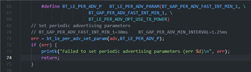

            #define BT_LE_PER_ADV_P   BT_LE_PER_ADV_PARAM(BT_GAP_PER_ADV_FAST_INT_MIN_1, \
    						  BT_LE_PER_ADV_OPT_USE_TX_POWER)
    	// Set periodic advertising parameters
    	err = bt_le_per_adv_set_param(adv,BT_LE_PER_ADV_DEFAULT);
    	if (err) {
    		printk("Failed to set periodic advertising parameters (err %d)\n", err);
    		return;
