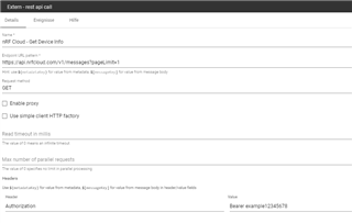

I use a Node-Red rule chain and send a GET to the following endpoint in a time-controlled manner:
As authentication I use the Simple Auth (changed the token for the screenshot). Exactly this setup worked without any problems in the last weeks.
When calling Node-Red I get the following exception:

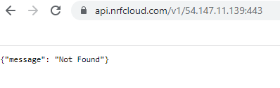

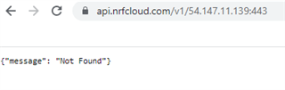

If I try to address the endpoint of the error message directly, it indicates that "/v1" must be added to the URL.
With the described adaptation, the connection seems to be successful :
