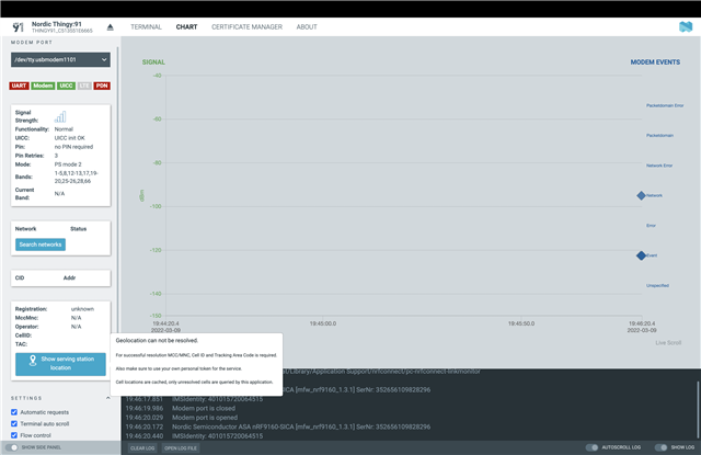

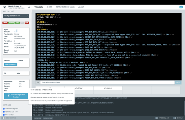

  • Hi Øyvind,
    Thanks for your reply.
    I attached screenshot for you information.
    Shakhizat
  • Hi Shakhizat,
    Thanks for providing this. From the signal strength and network field it does not look like your SIM has a connection. In the LTE Link Monitor there is a button marked "AT+CFUN?". Can you please click on this and then click on open log file in the bottom of the window. From here you should be able to copy and paste, or save and share the whole log output.
    Thanks!
    Øyvind

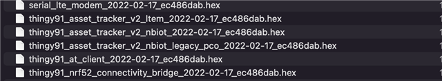

  • Øyvind,
    I attached txt file.
    Also, could your please suggest what application I need to flash into board?nbiot without legacy?I guess I am doing smth wrong here.

    2022-03-09T15:44:15.368Z DEBUG modem >> AT+CGEREP?
    2022-03-09T15:44:15.376Z DEBUG modem << +CGEREP: 1,0
    2022-03-09T15:44:15.376Z DEBUG modem << OK
    2022-03-09T15:44:15.378Z DEBUG modem >> AT+CIND=1,1,1
    2022-03-09T15:44:15.384Z DEBUG modem << OK
    2022-03-09T15:44:15.389Z DEBUG modem >> AT+CEREG=5
    2022-03-09T15:44:15.394Z DEBUG modem << OK
    2022-03-09T15:44:15.396Z DEBUG modem >> AT+CEREG?
    2022-03-09T15:44:15.402Z DEBUG modem << +CEREG: 5,4
    2022-03-09T15:44:15.403Z DEBUG modem << OK
    2022-03-09T15:44:15.412Z DEBUG modem >> AT%CESQ=1
    2022-03-09T15:44:15.418Z DEBUG modem << OK
    2022-03-09T15:44:15.420Z DEBUG modem >> AT+CESQ
    2022-03-09T15:44:15.427Z DEBUG modem << +CESQ: 99,99,255,255,255,255
    2022-03-09T15:44:15.428Z DEBUG modem << OK
    2022-03-09T15:44:15.436Z DEBUG modem >> AT%XSIM=1
    2022-03-09T15:44:15.443Z DEBUG modem << OK
    2022-03-09T15:44:15.446Z DEBUG modem >> AT%XSIM?
    2022-03-09T15:44:15.451Z DEBUG modem << %XSIM: 1
    2022-03-09T15:44:15.452Z DEBUG modem << OK
    2022-03-09T15:44:15.456Z DEBUG modem >> AT+CPIN?
    2022-03-09T15:44:15.462Z DEBUG modem << +CPIN: READY
    2022-03-09T15:44:15.463Z DEBUG modem << OK
    2022-03-09T15:44:15.466Z DEBUG modem >> AT+CPINR="SIM PIN"
    2022-03-09T15:44:15.481Z DEBUG modem << +CPINR: "SIM PIN",3
    2022-03-09T15:44:15.482Z DEBUG modem << OK
    2022-03-09T15:44:15.485Z DEBUG modem >> AT+CIMI
    2022-03-09T15:44:15.493Z DEBUG modem << 401015720064515
    2022-03-09T15:44:15.494Z DEBUG modem << OK
    2022-03-09T15:44:15.495Z INFO IMSIdentity: 401015720064515
    2022-03-09T15:44:16.319Z DEBUG modem >> AT+CESQ
    2022-03-09T15:44:16.332Z DEBUG modem << +CESQ: 99,99,255,255,255,255
    2022-03-09T15:44:16.335Z DEBUG modem << OK
    2022-03-09T15:44:17.322Z DEBUG modem >> AT+CESQ
    2022-03-09T15:44:17.332Z DEBUG modem << +CESQ: 99,99,255,255,255,255
    2022-03-09T15:44:17.333Z DEBUG modem << OK
    2022-03-09T15:44:18.321Z DEBUG modem >> AT+CESQ
    2022-03-09T15:44:18.338Z DEBUG modem << +CESQ: 99,99,255,255,255,255
    2022-03-09T15:44:18.340Z DEBUG modem << OK
    2022-03-09T15:44:19.323Z DEBUG modem >> AT+CESQ
    2022-03-09T15:44:19.341Z DEBUG modem << +CESQ: 99,99,255,255,255,255
    2022-03-09T15:44:19.343Z DEBUG modem << OK
    2022-03-09T15:44:20.321Z DEBUG modem >> AT+CESQ
    2022-03-09T15:44:20.335Z DEBUG modem << +CESQ: 99,99,255,255,255,255
    2022-03-09T15:44:20.337Z DEBUG modem << OK
    2022-03-09T15:44:21.322Z DEBUG modem >> AT+CESQ
    2022-03-09T15:44:21.336Z DEBUG modem << +CESQ: 99,99,255,255,255,255
    2022-03-09T15:44:21.341Z DEBUG modem << OK
    2022-03-09T15:44:22.318Z DEBUG modem >> AT+CESQ
    2022-03-09T15:44:22.328Z DEBUG modem << +CESQ: 99,99,255,255,255,255
    2022-03-09T15:44:22.330Z DEBUG modem << OK
    2022-03-09T15:44:23.321Z DEBUG modem >> AT+CESQ
    2022-03-09T15:44:23.338Z DEBUG modem << +CESQ: 99,99,255,255,255,255
    2022-03-09T15:44:23.340Z DEBUG modem << OK
  • Thanks for providing this information. From the log output I can see that you do not have any signal. The  Network registration status notification +CEREG command returns
    5 – Subscribe unsolicited result codes +CEREG: <stat>[,[<tac>],[<ci>],[<AcT>][,[<cause_type>],[<reject_cause>][,[<Active-Time>],[<Periodic-TAU>]]]]
    4 – Unknown (for example, out of Evolved Terrestrial Radio Access Network (E-UTRAN) coverage)
    Does the local SIM support NB-IoT? Are you using KCell? From the GSMA Deployment Map
    Have you tried both nbiot images from the precompiled package?
    Øyvind
