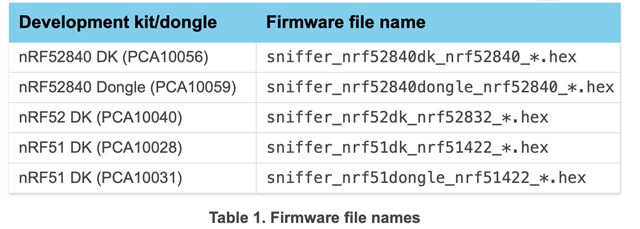

Step Three of "Programming the nRF Sniffer firmware" states:
3. Locate the firmware HEX file for your DK or dongle.

Where is the Sniffer_Software/hex/ folder noted in step 3?
Download via https://www.nordicsemi.com/Products/Development-tools/nrf-sniffer-for-bluetooth-le/download#infotabs
Suggest using the latest version.
Where is the sniffer_nrf52840dongle_nrf52840_*.hex file?
It's under nrf_sniffer_for_bluetooth_le\hex
Do I need to use the J-Link SW to download it?
It needs the J-Link SW to connect the device and program.
