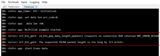

It will post NRF_ERROR_RESOURCES if I send 20 bytes to pperpherial device per 30ms in BLE_GAP_PHY_1MBPS

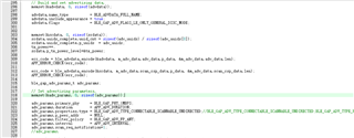

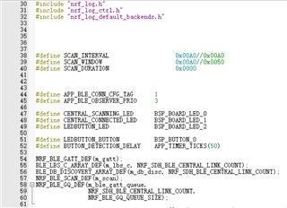

These are Central device 52840 settings:

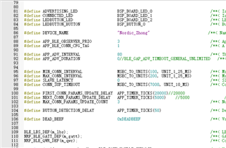

These are peripheral device 52810 settings:
I use official sdk16.0. Central Project is ble_app_multilink_central.Peripheral project is ble_app_blinky.Central device is 52840, peripheral device is 52810,

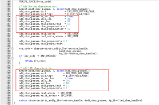

I change the ble service data len from 1bytes to 20 bytes.

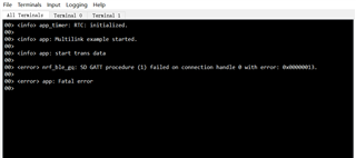

I create a app-timer to send data to peripheral device if there is a link that has post BLE_LBS_C_EVT_DISCOVERY_COMPLETE. If 52840 send data per 30ms, 52840 will print NRF_ERROR_RESOURCES log as shown in the figure above.
52840 send 20bytes to 52810 per 30ms, I don't think it exceeded the speed limit.

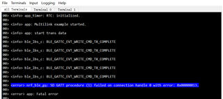

  • I change my code.52840 will send 20bytes when BLE_LBS_C_EVT_DISCOVERY_COMPLETE is posted and I will send data in  BLE_GATTC_EVT_WRITE_CMD_TX_COMPLETE handler,It will still post <error> nrf_ble_gq: SD GATT procedure (1) failed on connection handle 0 with error: 0x00000013.
    So should i do?

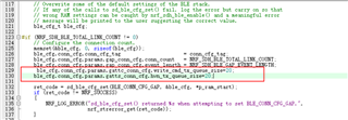

    If you read the description of hvn_tx_queue_size you can find that it is:
     Minimum guaranteed number of Handle Value Notifications that can be queued for transmission.
    It's not the actual queue size but the minimum guaranteed buffer you will have. It also does not directly decide the number of the packets/data you will send on each connection event. It's the NRF_SDH_BLE_GAP_EVENT_LENGTH , NRF_SDH_BLE_GATT_MAX_MTU_SIZE, and the connection interval that decide it.
    A large queue size doesn't mean you will have a high throughput. See this case.
    You can't get the number of buffer you have left, but if you queue and get NRF_ERROR_RESOURCES this meant the packet is not queued and you need to wait for a BLE_GATTS_EVT_HVN_TX_COMPLETE (for notification) or BLE_GATTS_EVT_HVC (for indication) to continue queueing.
    It's important to have a higher throughput on BLE is to have large enough ATT_MTU, large enough NRF_SDH_BLE_GAP_DATA_LENGTH (4 byte longer that ATT_MTU), long enough EVENT LENGTH (that it cover the entire connection interval), and not too long connection interval (for example 30-50ms).

    2、According to my printed log, host send data to slave once, but RTT_Viewer print eight BLE_GATTC_EVT_WRITE_CMD_TX_COMPLETE logs, it means that host  threw eight this events.Why is this happening?

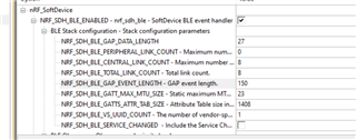

    Host Device Settings:
    MAX_CONNECTION_INTERVAL    150ms
    MIN_CONNECTION_INTERVAL      100ms
    NRF_SDH_BLE_GAP_DATA_LENGTH   60
    NRF_SDH_BLE_GAP_EVENT_LENGTH   140
    NRF_SDH_BLE_GATT_MAX_MTU_SIZE   53
    NRF_SDH_BLE_GATTS_ATTR_TAB_SIZE 2048
    Peripheral  Device   Settings:
    NRF_SDH_BLE_GATTS_ATTR_TAB_SIZE 1408
    NRF_SDH_BLE_VS_UUID_COUNT 10
    1、I change my MTU size from 23 to 53,as shown in the figure.Then Host RTT_Viewer print this log.Are any of those Settings wrong?
    If you would like to set MTU size 53, then the data length should be 54.
    NRF_SDH_BLE_GAP_DATA_LENGTH   57
    qiao said:
    2、Host write one package to slave, why does host threw eight BLE_GATTC_EVT_WRITE_CMD_TX_COMPLETE events?
    See this answer.
