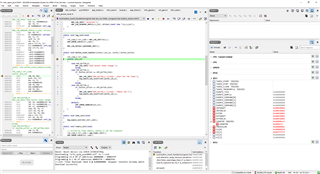

Also just in case it's helpful, here is a screenshot of my project directory:
I've spent 2 days on this and am feeling pretty dumb at this point - writing and re-writing just trying to get a demo where I can start SPIM/easyDMA transfers with a push button! Any/all advice would be much much appreciated. Why would I pull in code from ble_app_blinky? Well I'm putting together some firmware that essentially turns an nrf52840 into a SPI <-> BLE pipe. I have all the BLE side of things working in another project, I wanted to spin up the SPI side of things separate but I wanted to use similar blocks that already exist in my BLE firmware.
  • Hi Jared!
    Of course! I've attached a zip of the project folder. This is with SDK v16 (which I just realized is not up to date - I can do this in SDK v17 if you think that can make a difference.
    Using the BSP module is ok, but note that it's made for our development kits in case you're not going to use our devkits in the future.
    This is a really good thing to know! Thank you for clarifying this - this also explains why it wasn't working on my custom board (that I've been trying to bring up in parallel to this).nrfx_spim_bsp.zip
  • Hi Ryan!
    I looked at your code and was able to reproduce the issue. The app_button module uses the GPIOTE and the app_timer modules, the latter is used for preventing any debouncing when you press a button. During debugging I noticed that the app timer callback handler is never called after it has been started when a button is pressed. I then checked the RTC registers and saw that the counter was never incremented after the timer was started. This resulted in me checking if the timers was correctly started, and I noticed that you never start the LFCLK clock in your application. App timer use the RTC peripheral which again use the LFCLK peripheral. In Softdevice applications you don't need to start the clock manually as it's started by the Softdevice. Which explains why you didn't include it when you ported the app button from the blinky example. However in peripheral examples that do not use the SD, you have to start it manually before you initialize the app timer module. I did that and it fixed your problem Slight smile. I've attached the patched code below.

  • Hi Jared,
    Thank you so much! This makes a lot of sense!! I've dealt with this issue on and off for MONTHS and I can't believe it really boiled down to a missed init function.
    Firstly thank you for your time helping me with this. I especially wanted to thank you for walking through your debug steps as well. I'm sure you've noticed this already, but my debugging skills are a little lackluster. You've given me some great example debug processes between the watches and this latest walkthrough on checking RTC registers (I now understand the connection between the GPIO, App timer, and RTC blocks!).
