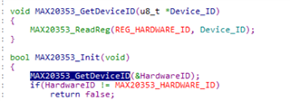

  • When the system starts, initialize a peripheral, read the device ID through I2C, but the system crashes during the reading process, here is its location and execution code:

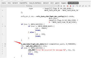

    In an earlier comment you pointed to k_sem_take_forever(), and I then wondered if you passed the correct parameters to the function. Can you again show me exactly where the programs stops after you hit an error?

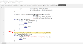

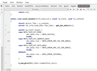

  • As I said, it crashes when it runs to the function k_sem_take().  This function is in line 79 of file i2C_nrfx_twim.c.

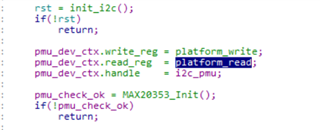

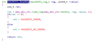

    This is my interface function for i2C initialization and read/write operations, and it should look fine.
