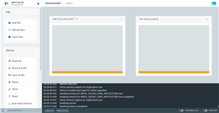

what happens if you run nrfjprog --readregs? Can you flash using the nRF Connect programmer app?
Hi Hakon:
Now it's OK,because I chose nrf9160dk_nrf9160_ns.

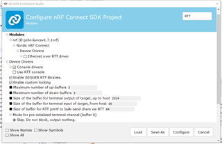

But there is another problem.SES does not output log.
RTT enabled
And using uart tool, it has log output.so fw is ok.
So how to config ses log output? thanks.
You should enable
CONFIG_RTT_CONSOLE=y,
as far as I can tell it's not enabled in the application. Also, if you haven't done it you should also enable
CONFIG_UART_CONSOLE=n
