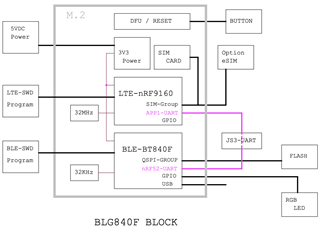

  • They provide this block diagram which has App1-UART of the 9160 connected to nRF52-UART of the BT840F via the JS3 connector.  I looked through the 9160 datasheet and couldn't find any labeling of APP1 so I wasn't sure what that was referring to, and same with nRF52 in its datasheet.  It says that uart pins such as psel.rts can be mapped to pins, but psel.rxd, psel.rts etc. were all mapped to P0.31 so I didn't understand this.  Wouldn't these need to be separate pins physically?

    I noticed the same diagram, but it is not very specific unfortunately.
    I am not sure what they mean by App1-UART either, to my knowledge we don't have any references to this in our documentation. Possibly they reused the pins used by the respective board files of the nRF9160 and nRF52840 DK's, but this is just speculation.
    In the BT840 schematic they mention UART_TX on pin 1.02 (C5) and UART_RX on pin 1.01 (D5), but whether or not this is the UART pins they use in the BLG840X is anyone's guess.
    Could you try to contact Fanstel directly and ask if they have some more documentation that would provide these details?
    I guess it is possible to write some code for the two devices that toggle each and every pin one after the other in one device, and read all the GPIO's in the other device to see which one changes, but this is a pretty cumbersome way to figure out how they are connected.
