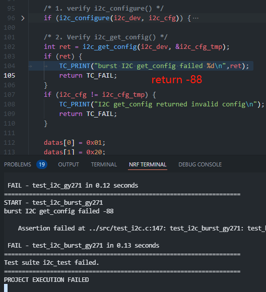

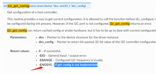

it can build runing,but i2c_get_config() fail.return -88.
nRF5340-DK  does not connect anything.
test  default codes from NCS1.9.1,
that is [\v1.9.1\zephyr\tests\drivers\i2c\i2c_api],
Do I have to link to peripheral I2C devices?
