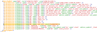

  • You can see where the .non_init section is located in RAM from the memory usage view in SES here (or from the *.map output):
    Can you believe, I did exaxtly that last night? I found out that my variable lives at 0x20003F00, i.e in the section RAM 1. When I turned off all sections except that one, it worked just fine! How cool is that?
    Important: the .non_init section does not start at a fixed address. So it may change between builds. E.g. when you turn off or enable compiler optimization.
    This is what I also noticed. Is there a way to fix a variable at the given section and make sure it stays there every time?
  • Yes, you can specify a fixed start address for the non_init section in your flash_placemecement.xml file.
    e.g.
    Note that this fixed address must be somewhere between .tbss and   .heap (or .stack if you don't use heap).
  • Cool. One last question: in short words, how does the compiler (linker?) determine the addresses of all those sections? I always though it was pregiven in the .ld file (though I never bothered to look it up there)
  • The linker starts with the first sections and sequentially works its way up one section at a time. So the start address of a section is usually dependent on the size of previous sections. You may, for instance, notice that .non_init gets shifted up when you add more static zero initialized variables in your code (placed in .bss)
    SES generates the actual linker script from the flash_placement.xml file. The generated linker script can be found together with the other output files.
