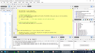

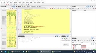

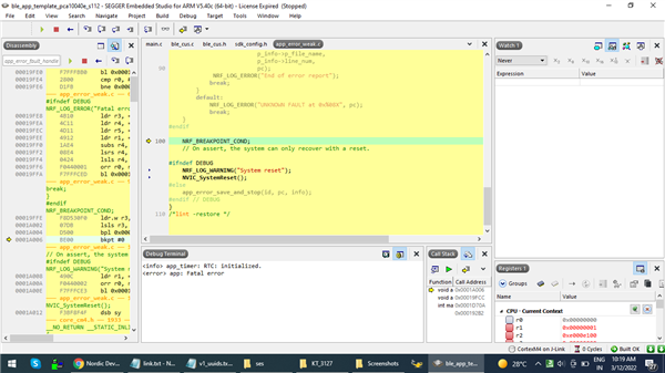

Hello i am using nrf52810 with SDK version 17.0.2 , i want to add custom service to the ble_app_template example and i followed this tutorial link https://github.com/edvinand/custom_ble_service_example so at first debug i got this error as expected

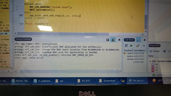

next i have change the RAM_START AND RAM_SIZE as per the memory size mentioned in the error then i DEBUG it again so the i got
so i don't know what's happening please help me to resolve this .

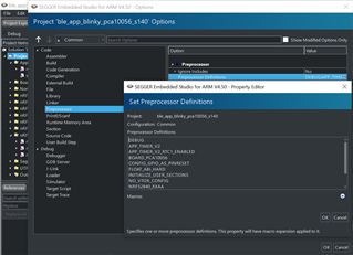

    Please make sure to have DEBUG defined in your preprocessor defines, like shown in the included image:
    This will make your logger output a detailed error message whenever a non-NRF_SUCCESS error code is passed to an APP_ERROR_CHECK.
    Please do this, and let me know what the error message reads, along with which function that returned the error code pointed to in the error message.

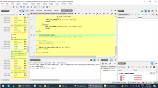

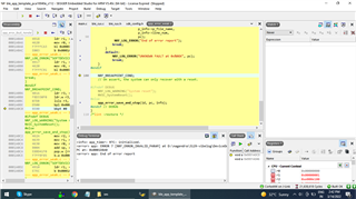

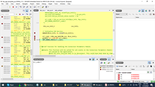

    mr Karl i am very happy to communicate with you and thank you so much for your reply, i tried as you said  and i got this error,
    thank you,

    so i don't know i am blanked what to do i tried so many times if i comment the  p_cus_init->evt_handler == NULL in ble_cus_init() function then it starts advertising. so please help me to resolve this.
    But this does not solve the underlying issue, it is just treating the symptoms. If you just remove error checks that fail the errors will still be there, you just will not know about it.
    To fix it, and make it function as expected you will need to resolve the underlying issue.
    sagarnayakm said:
    i got issue like the p_cus_init->evt_handler == NULL in ble_cus_init() function after this its not executing
    Have you implemented and provided an event handler for your custom service during its initialization?

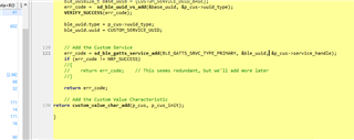

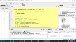

    No, i added but from that only problem created right..?? so removed. the updated ble_cus_init() function is
    ret_code_t ble_cus_init(ble_cus_t * p_cus, const ble_cus_init_t * p_cus_init)
        NRF_LOG_INFO("i am cu_init\r\n");
        if (p_cus == NULL || p_cus_init == NULL || p_cus_init->evt_handler == NULL)
            return NRF_ERROR_NULL;
        ret_code_t  err_code;
        ble_uuid_t  ble_uuid;
        // Initialize service structure
        p_cus->evt_handler               = p_cus_init->evt_handler;
        p_cus->conn_handle               = BLE_CONN_HANDLE_INVALID;
        // Add Custom Service UUID
        ble_uuid128_t base_uuid = {CUSTOM_SERVICE_UUID_BASE};
        err_code =  sd_ble_uuid_vs_add(&base_uuid, &p_cus->uuid_type);
        VERIFY_SUCCESS(err_code);
        ble_uuid.type = p_cus->uuid_type;
        ble_uuid.uuid = CUSTOM_SERVICE_UUID;
        // Add the Custom Service
        err_code = sd_ble_gatts_service_add(BLE_GATTS_SRVC_TYPE_PRIMARY, &ble_uuid, &p_cus->service_handle);
        if (err_code != NRF_SUCCESS)
            return err_code;    // This seems redundant, but we'll add more later
      // Add the Custom Value Characteristic
        return custom_value_char_add(p_cus, p_cus_init);

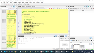

    but still same result and in service _init() if i comment memset of cus_init() then  advertising happened and i wrote two lines to receive the data which i have sent is it correct because whatever  the data if i sent same number was received.
    so i have correct this that is my bad i added extra return this issue is resolved
