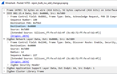

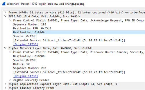

  • Hi Abele,
    Since the door sensor lost connection to its parent when the coordinator was reset it will try to rejoin the network to get a new (or the same) parent. You can see that the bulb is the new parent since the door sensor sends an end device timeout request to it (packet 14735). Later, the door sensor sends a network address request to find the short address of the coordinator (packet 14746), and from this it will find that the coordinator is in the neighbor table of the bulb, so it knows the route to the coordinator (door sensor -> bulb -> coordinator), and can now send packets to it via its parent. It might seem like the packet is sent directly, but if you inspect the packet and compare it to similar packets sent when the coordinator was the parent you will see that there is a difference.
    Coordinator as parent:
    Bulb as parent:
    As you can see, the destination in the network layer frame is still the coordinator in both cases, because the final destination of the packet is still the coordinator. However, in the case where the bulb is the parent device the destination in the 802.15.4 MAC data frame is the bulb, and not the coordinator. So the packet is routed via the bulb when it is sent from the door sensor and to the coordinator in this case.
