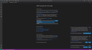

    Created application from an example. It offers 1.9.0, but I select 1.9.1
    (Where did it find the 1.9.0?)
    Extension conflict
    I clicked "Show conflicting extensions"
    After restarting the change watcher, it, again, suggests using c:\ncs\v1.9.0\zephyr.
    I clicked "Change" and selected v1.9.1
    Had to restart the change watcher, because touching the snipping tool made
    the notification disappear without selection.
    Then I restarted changes watcher again, and again it suggests c:\ncs\v1.9.0\zephyr.
    Note, that there is no folder c:\ncs\v1.9.0 any more. Only c:\ncs\v1.9.1.
