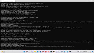

i had  read mac id of nrf52832 using python and adalink. Now my window is updated from window 10 to window 11

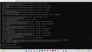

so i have to reinstalled all setup while reinstalling python 27 is installed but problem in installation of  Adafruit_Adalink project on Github
when i run the command python setup.py install I got a following response on CMD tool.
I have refer this for read MAC id installation
