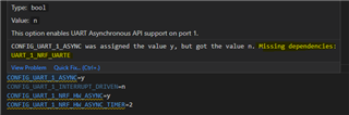

    CONFIG_NRF_SW_LPUART=y
    CONFIG_NRF_SW_LPUART_INT_DRIVEN=y
    CONFIG_UART_2_ASYNC=y
    CONFIG_UART_2_INTERRUPT_DRIVEN=n
    CONFIG_UART_2_NRF_HW_ASYNC=y
    CONFIG_UART_2_NRF_HW_ASYNC_TIMER=2
    CONFIG_UART_1_ASYNC=y
    CONFIG_UART_1_INTERRUPT_DRIVEN=n
    CONFIG_UART_1_NRF_HW_ASYNC=y
    CONFIG_UART_1_NRF_HW_ASYNC_TIMER=2
    But the UART_1 has missing dependencies which i cannot add in
    if i could steal the UART instance that the logging uses that would be fine also...

  • Hi, sorry for the late response.
    I assume you are building for non-secure? If so, try adding this to the uart1 node in the overlay:
    status = "okay";
